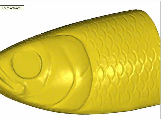

BobCAD-CAM Support 19 hours, 6 minutes agoIn my first attempt I believe BC cut the mold to the T, I just had a bad model. I have removed the back face and inserted into my drawing. I will use the slice planar, tol .0001, stepover .003, 1/16 ball mill. […] -

BobCAD-CAM Support 1 day, 11 hours agojust a stab in the dark,but I am thinkin that slice plane the fish with smallest endmill feasible,set tolerances close,etc.,etc.Then if somehow you could make the fine geometry into single line,then do a 3D […] -
jrmach replied to the forum topic machining detail in the group
BobCAD-CAM Support 1 day, 11 hours agoeither a .0325 tool or smaller is goin to be necessary.Also take in consideration tool step over. -

BobCAD-CAM Support 1 day, 14 hours agoHi dlaery, You wont have to do a booean subtract to get your shells for a mould. Just go to the bottom of that model and unstitch the bottom surface and delete it…. Instant mould!!!

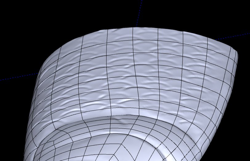

BobCAD-CAM Support 1 day, 19 hours agoThanks, that is a big help! I opened my original file I did the machining on and it is not any better in display, or in machining at the smaller tolerance. I had originally imported the step file in Alibre, laid […] -

BobCAD-CAM Support 2 days, 7 hours agoHi dlaery, So the file looks good. Here is a backplot of the file with a slice planar, .0625 ball with a .008 step over. Also, a picture of the toolpath on the surfaces with a machining tolerance of […] -

BobCAD-CAM Support 2 days, 10 hours agoI hogged out the cavity with a 1/4” ball mill, then used a 1/8” and then finished with a 1/16” ball mill using the Equidistant offset. Here is the file I started with. -

BobCAD-CAM Support 2 days, 11 hours agoHi dlaery, The view sliders “ARE” just for display, but it lets us know that the model data is there in the NURBS model (The prefered one to the STL) Now we need to find out why your toolpath is not […] -

BobCAD-CAM Support 2 days, 12 hours agoThe mold is 6” x 2-1/2” It holds 2 – ”fish heads” The ”fish head” is 1-1/4” x 2-1/4” -
dlaery replied to the forum topic machining detail in the group
BobCAD-CAM Support 2 days, 12 hours agoWow, now I am confused. After turning up the sliders the stp part file looks perfect.
The sliders shouldn’t have any effect on the machining should they?, because that is just display, right?
I turned up […] -
burr replied to the forum topic machining detail in the group
BobCAD-CAM Support 2 days, 14 hours agodlaery, The stp or iges would be preferable over the stl. Any detail in the stl should be represented in the original file. Could you check the display settings for the stp or iges and look at wireframe and […] -

dlaery started the forum topic machining detail in the group
BobCAD-CAM Support 2 days, 17 hours agoI have been sent a scanned part in iges and in stp formats. The scanning company has sent a pdf of this file from Solidworks showing the scale detail on the side.
When I open the stp file in BC the detail […] -
