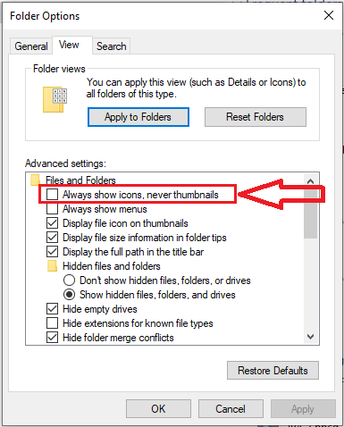

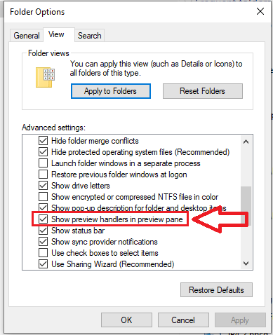

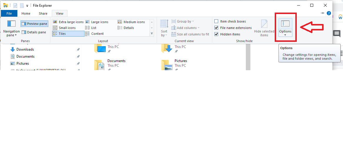

Solution 1 (Windows Explorer Settings):
There are two options you need to check in windows explorer.
1. Open up Windows Explorer and click the โ€œViewโ€ tab located at the top of the window.
2. Select the โ€œOptionsโ€ button
3. There will be another tab called โ€œViewโ€. Select it.
4. Deselect where it says โ€œAlways show icons, never thumbnailsโ€
5. Select where it says โ€œShow preview handlers in preview paneโ€
6. Click โ€œApplyโ€ and โ€œOKโ€
