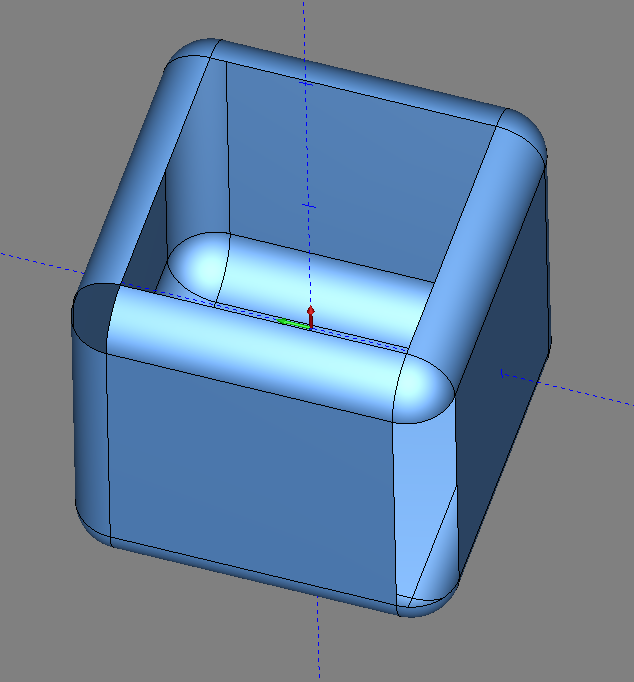

Pic. 1 - Example for this Article: A Cube with Missing Surfaces
Pic. 1 shows a Cube model that will be used in this example. It has three missing surfaces.

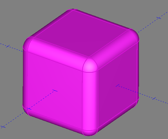

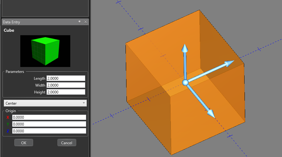

Pic. 2 - Cube
1. Go to Create 3D and select Cube
2. Set the Length, Width and Height to 2, if not already by default
3. Press OK then Cancel

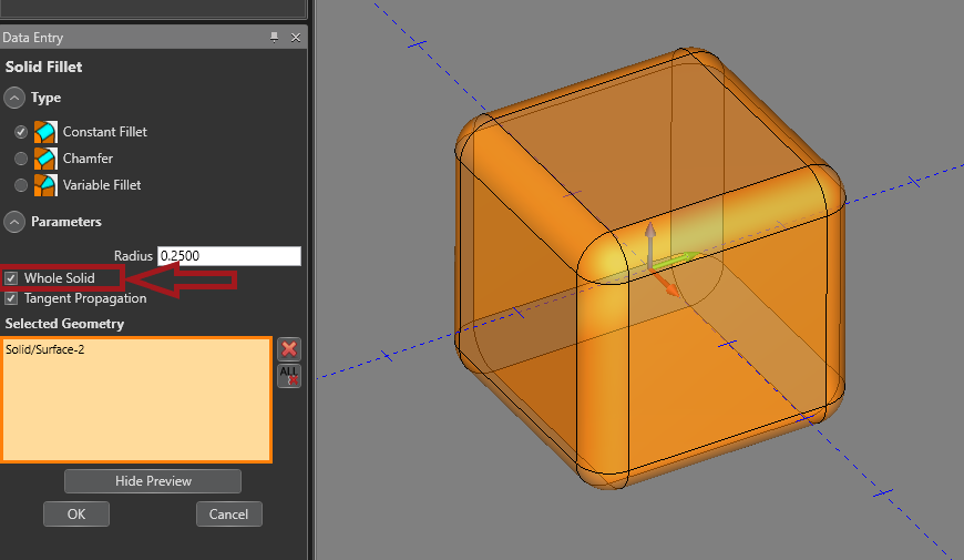

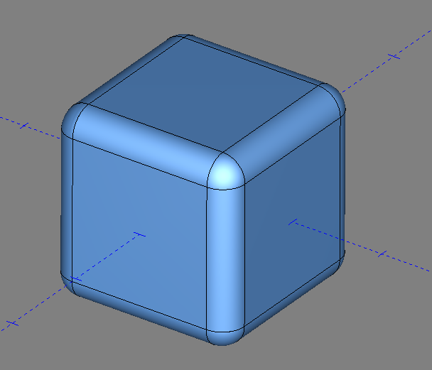

Pic. 3 – Fillet Cube
4. In the Create 3D tab, select Solid Fillet
5. Check off the box that’s says, “Whole Solid” and select the Cube as the Selected Geometry
6. Press OK then Cancel

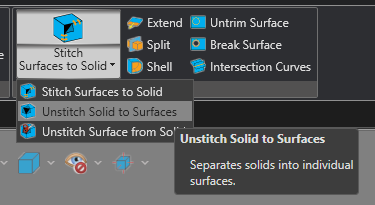

Pic. 4 – Stitch Solid Menu
7. In the Create 3D tab, click the drop-down menu where it says, “Stitch Surfaces to Solid”
8. From the menu, select Unstitch Solid to Surfaces

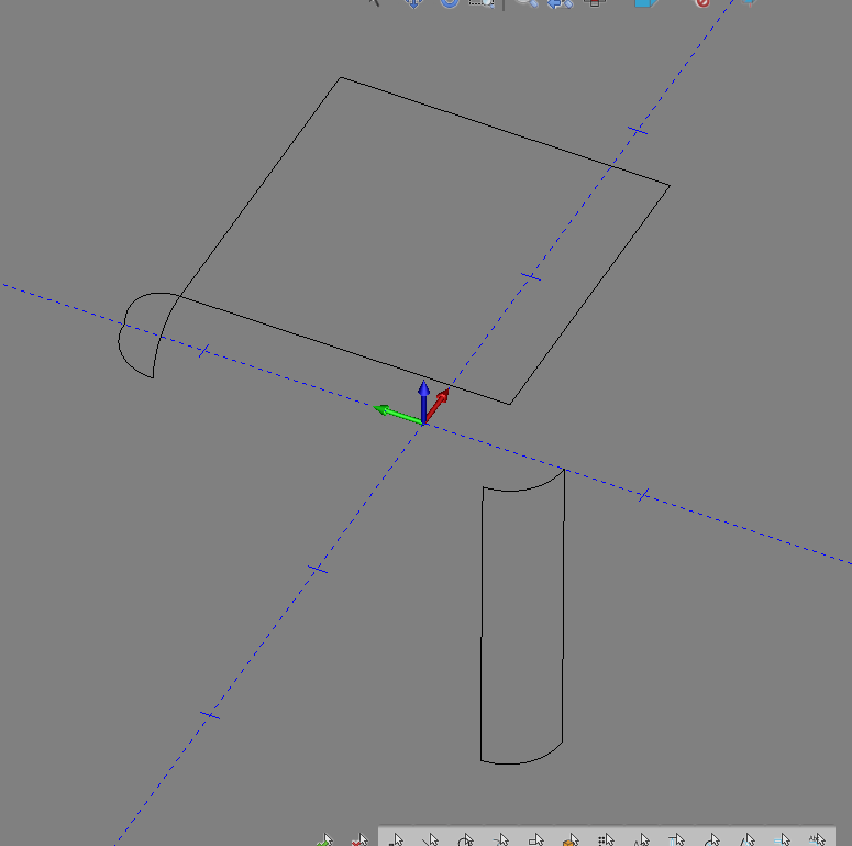

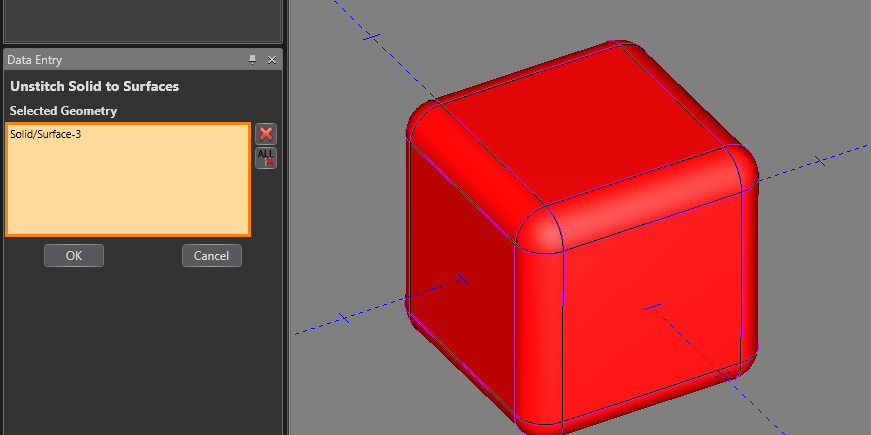

Pic. 5 - Unstitch Cube
9. Select the Cube as the Selected Geometry
10. Press OK then Cancel

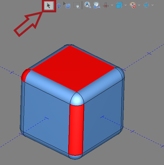

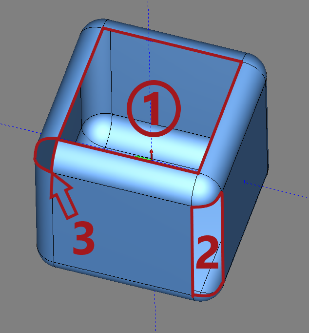

Pic. 6 – Delete Surfaces
11. Enter Select Mode by selecting the (Select Mode) icon at the upper left of the graphics area
12. Select the three surfaces that you want to delete
13. Press the Delete button on your keyboard

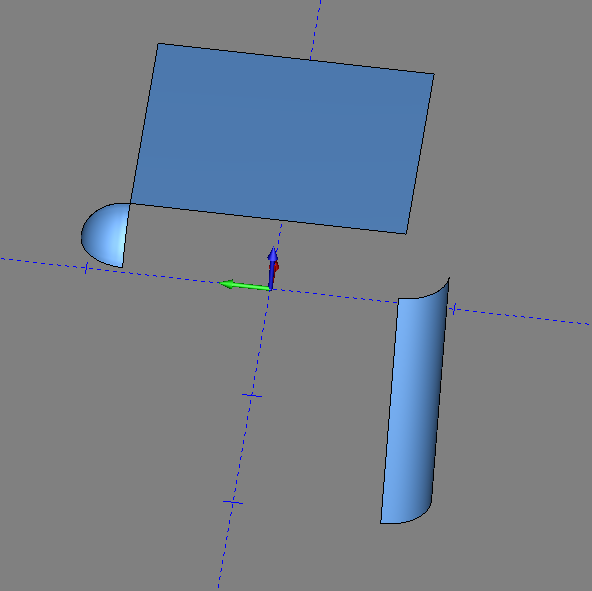

Pic. 7 – 3 Missing Surfaces
Pic. 7 shows the model we created in the previous steps above. It shows the three missing surfaces.

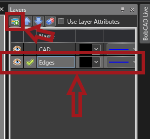

Pic. 8 – Layers Window
The Checkmark signifies which layer is active. Geometry created will be placed in the active layer.
1. Go to the Layers Window and select the (New Layer) icon
2. Name the newly created layer “Edges” and make sure the Checkmark is selected for the Edges Layer.

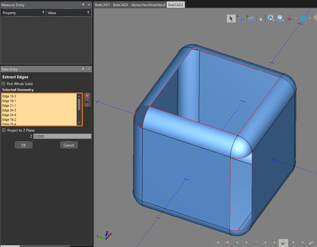

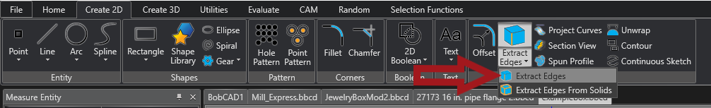

Pic. 9 – Extract Edges
3. Go to the Create 2D tab and Select the Extract Edges function
Pic. 10 – Extract Edges Selection
Note: Make sure the Project to Z Plane box is unchecked
4. Select the Edges of the three missing surfaces from the existing surfaces
5. Press OK then Cancel

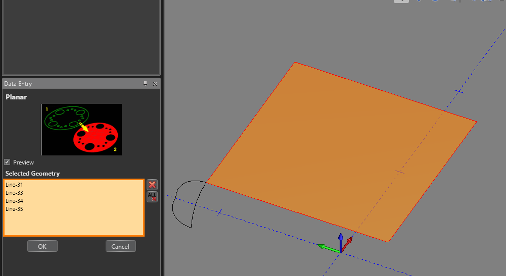

Pic. 12 – First Surface Creation (Planar Surface)
7. Go to the Create 3D tab and select the Planar surface function in the Surfaces group
8. Select the top four lines for the Selected Geometry to create a flat surface at the top of the model
9. Press OK then Cancel

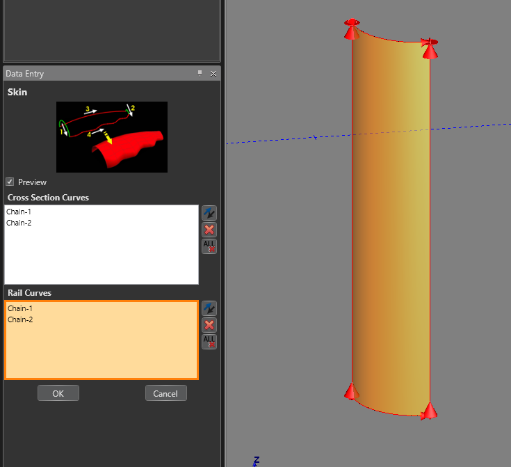

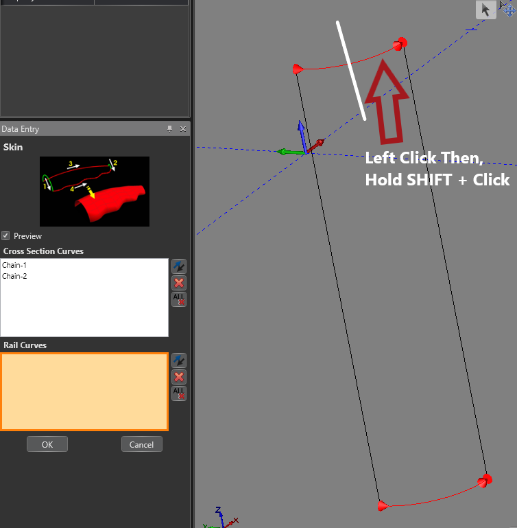

Pic. 13 – Second Surface Creation (Skin Surface)
10. In the Create 3D tab, select the Skin function in the Advanced Surfaces group
11. The Cross Section Curves box will already be active (highlighted orange). Create two chains opposite from one another (shown in Pic. 13).
Create a chain by clicking on one half of the entity to start the chain. Then, Hold SHIFT + click in the same location to complete the chain. Make sure that the chain face the right direction shown on the example in the Data Entry Window.
  •       Click inside the Rail Curves box to make it active. (It should highlight orange)
  •       Create two more chains with the other two lines perpendicular to the Cross Section Curves.
Pic. 14 – Skin Surface Preview
Note: Once all chains are created, there will be a preview show up of the surface
12. Press OK then Cancel

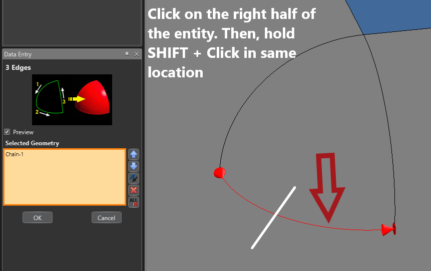

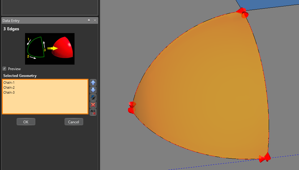

Pic. 15 – Third Surface Creation (3 Edges Surface)
13. In the Create 3D tab, Select the 3 Edges function in the Surfaces group
14. Create three chains, all moving in the same direction, for the Selected Geometry (one for each arc)
Pic. 16 – 3 Edge Surface Preview
15. Press OK then Cancel

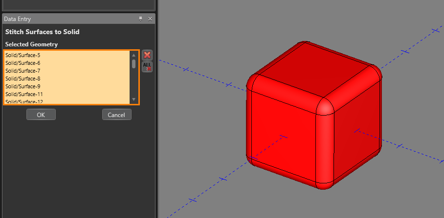

Pic. 19 – Stitch Surfaces to a Solid Model
17. In the Create 3D tab, select the Stitch Surfaces to Solid function
18. Drag a box over all the geometry to add it to Selected Geometry
19. Press OK then Cancel

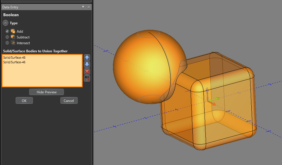

Pic. 21 – Boolean Add Two Solids
20. In the Create 3D tab, create another solid that intersects the cube
21. Also, in the Create 3D tab, select the Boolean function
22. Make sure the Add box is checked off and select both solid models
23. Press OK then Cancel to combined both models into one solid
