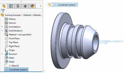

Creating a Coordinate System in SolidWorks
1.  Go to the Features page in SolidWorks
2.  Hit the Reference Geometry drop down box
3.  Under Reference Geometry, create a Coordinate System
4.  Left Click on the Selections Box and select where the Coordinate System shall be centered around
5.  For the X Axis, Y Axis, and Z Axis select a line that is parallel to the Axis.
6.  Click on the green check mark

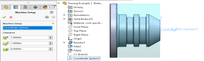

NOTE: Make sure the Coordinate system you define in SolidWorks has the Z axis along the center of rotation. In Machine setup select this coordinate system for the Machine Setup.
A picture containing diagram Description automatically generated
After the coordinate system is defined you can define your clearances on the same page. The 3 parameters are described above.
