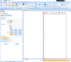

1. In the Create 2D tab, select the Rectangle option.
2. For the length and width of the rectangle, input the values of the spoil board that is being faced.
NOTE: This example will use a 4’ x 8’ spoil board or 48” x 96” (Length x Width).
3. In the Base Point section, select the bottom left corner option to place the geometry in the upper right-hand quadrant. Click OK, then Cancel.

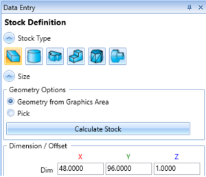

5. For the “Job Type”, select Milling and choose your machine from the drop-down if it's not already there by default. Then, click Stock Wizard.
6. On the Workpiece page, no workpiece needs to be selected. Click the ">>" forward arrow button
7. In the Stock Wizard, make sure the X dimension is set to 48 and the Y dimension is set to 96. Then, click ">>".
Note: If you made the geometry before starting a New Job, the stock should automatically generate to the correct size in this case.

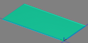

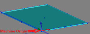

8. On the Machine Setup page, leave the machine origin set to X0, Y0, Z0 . Then, click OK.
Pic. 3 Setting the Machine Setup Origin Page
Pic. 4 Machine Origin Location

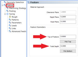

11. On the Feature page (shown in the image below), keep the Top of Feature set to the default as this value is automatically set to 0.0000. This is because our top of the stock is in relation to the Machine Origin. Adjust the Depth to the depth of cut from the top of the spoil board. In this example, we will leave this value set to 0.1000. Click, Next until you get to the Tool Page (Rough).

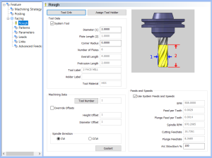

12. On the Tool Page (Rough) (shown in the image below), choose the tool that will be used in the facing feature. In this example, a 2 Diam Face Endmill will be used.
Note: To access this tool from the Tool Library, click on Tool Crib > Add From Tool Library. Sort by Diameter by clicking on Diameter column at the top and find the default tool called, "2 Face MILL". Select it and click OK. Then, OK again. Click, Next.
