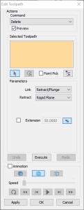

Fig 1 – Edit Toolpath Dialog Box
The Edit Toolpath window is shown above. Here, you can see that there is a “Command” section, a “Selected Toolpath” and “Parameters” section that allows you to adjust the parameters of the toolpath and the “Animation” section that allows you to backplot toolpath before you apply the changes.

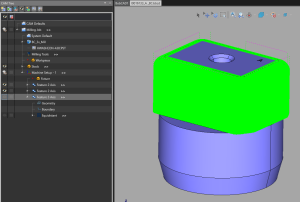

Fig 2 – Example Part

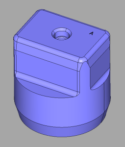

Let’s consider a part like the example above. We will create toolpath for the flat walls on the top half of the part. This can be achieved by using a 3-axis toolpath like “Advanced Z Level Finish” or “Equidistant”.

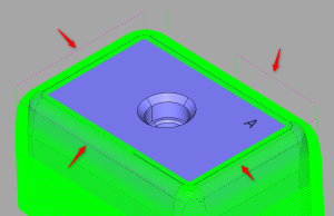

Fig 3 – Equidistant Toolpath
At first glance, this toolpath looks pretty good. It has created toolpath in the exact areas we wanted.

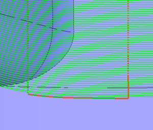

Fig 4 – Rapid Retract moves
However, upon looking closer, we can observe that there are some rapid retract moves that retract all the way from the bottom of the toolpath to the top.
Fig 5 – “Extra” Unwanted move

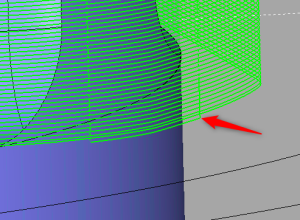

And, if you look even closer, you can see that these retract moves are coming from tiny feed moves at the bottom of the toolpath. What we expected to see was one clean and continuous final pass.

Fig 6 & 7 – Bottom of Job
To make sure the toolpath stays only on the flat wall areas, we set a Bottom of Job a couple thou above the flat floor. (Z-2.498)
Fig 8 – Z value (Inside Backplot of Equidistant Toolpath)
If we look closer at these tiny entities, in a “Backplot”, we can observe that they are indeed above the Bottom of Job set for this Equidistant Operation.
The lowest Z value in the “extra” entities is -2.49825. Given that our Bottom of Job is set to -2.498 and our Machine tolerance set to 0.0005, this toolpath is within the parameters set for the feature.

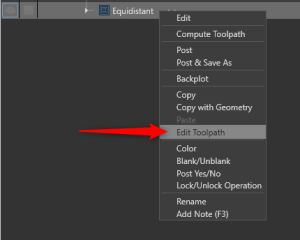

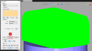

1. Right-Click on your Operation (Not the Feature) and select “Edit Toolpath”

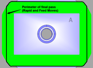

If we observe these feed and rapid moves that contain the tiny moves, we can notice that they are all connected together. This is because they are all part of the final pass in the toolpath and have been partially trimmed like we observed in the “Backplot” previously.

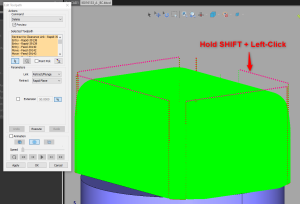

Because of this, we can use the Chain Select method that is used for CAD when selecting lines, arcs, or splines. To Chain Select, Left-Click on the entity where you want to start the chain. Then, Hold SHIFT + Left-Click on the last entity of where you want to end the chain. (Follow steps 2 and 3)
2. Left-click on starting Rapid move
In this case, this happens to be the last move in the toolpath.
3. Hold SHIFT + Left-Click on the Rapid move (Up to the point at which you want to delete.)
Observe that it will highlight all the moves in between the Start and End of the Chains selected.
We can zoom in and observe that our tiny moves are indeed selected.
4. Press “Execute”
Observe that all Rapid and Feed moves are deleted at once.
5. Hit “Apply”. Then, “OK” to apply all changes.
