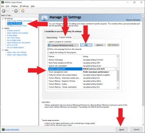

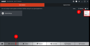

2. Next, Right-click anywhere on your Desktop and select the Control Panel for your graphics card. (In newer versions of Windows, you may have to Search it in the Search Bar instead.)
For NVIDIA, go to "Manage 3D settings" --> "Program Settings". click the Add button and select BobCAD. Then, click apply at the bottom right of your screen.
For AMD, there is a tab called "gaming". Click on that. Then, click the Add button. find BobCAD and add it.

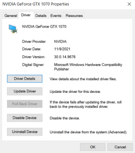

1. Go back to the Display Adapters section in your Device Manager dialog to navigate to your dedicated graphics card again.
2. Right-click on your Graphic Card and select Properties. Click on the Driver tab. You can try clicking the "Update Driver" button from here, but it does not always find the most up-to-date driver.

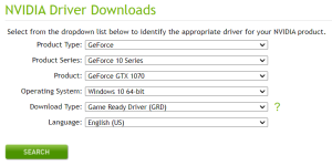

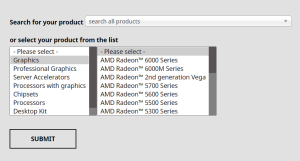

We suggest going to your graphics card company's website to find the most up-to-date drivers. Then, download and install it from there.
**NVIDIA Drivers Website: https://www.nvidia.com/Download/index.aspx
**AMD Drivers Website: https://www.amd.com/en/support
