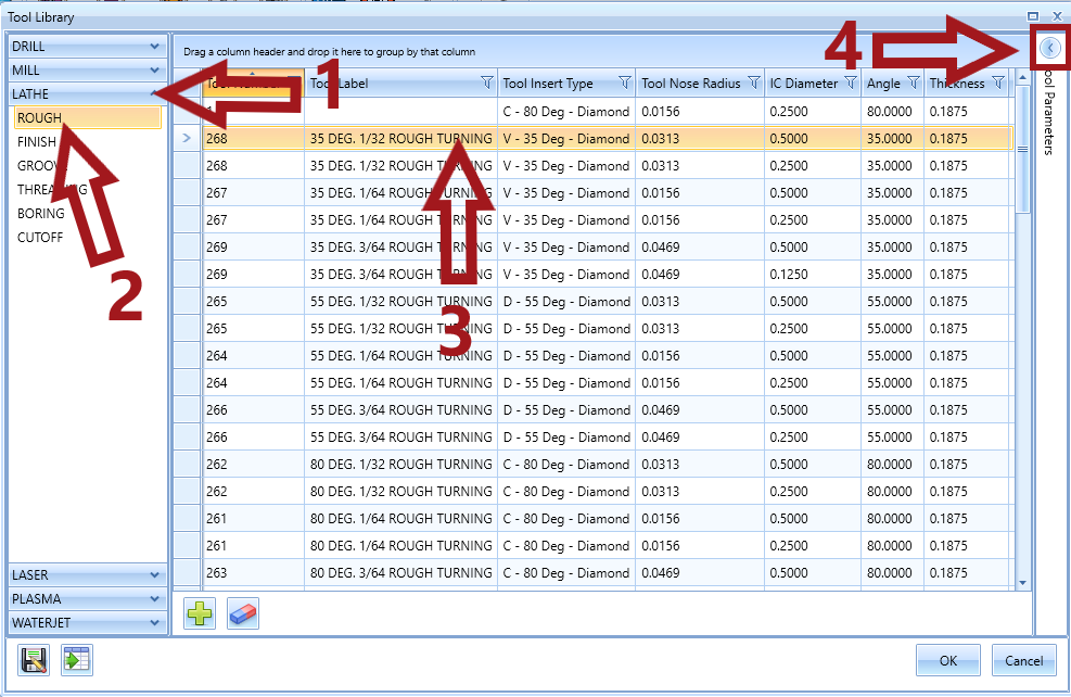

1. Go to the CAM Tree and right click on Turning Tools after creating a job. Then, select Tools
2. Navigate to the tool type you are using on the left hand side. For this example, go to the Rough section under Lathe (Steps 1 & 2 in Pic. 1)
3. Select the tool you want to use and click on the arrow in the top right for Tool Parameters (Steps 3 & 4 in Pic. 1)

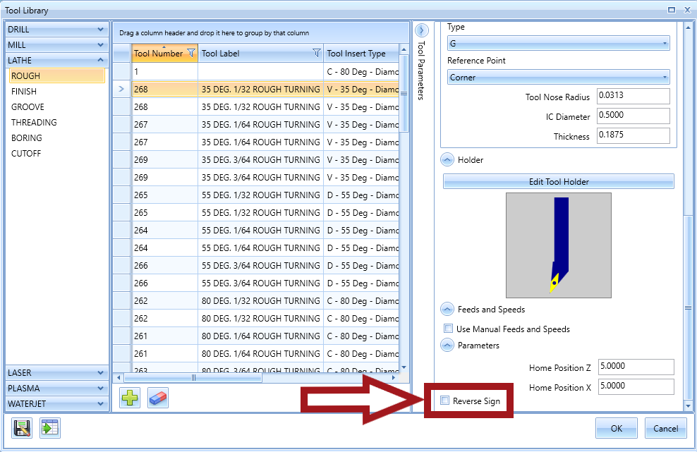

Pic. 2 – Modify Tool
4. Scroll down to the bottom of the tool parameters, you will see an option labeled Reverse Sign. Click the box to check-off this option.
5. Press OK

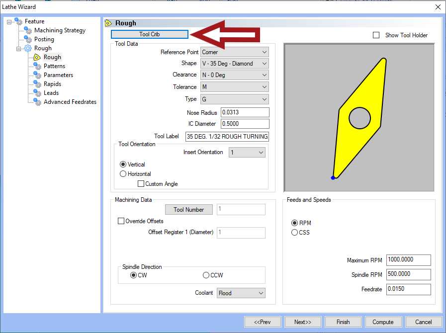

7. Go to the Tool Page (shown in Pic. 3) and select the Tool Crib button

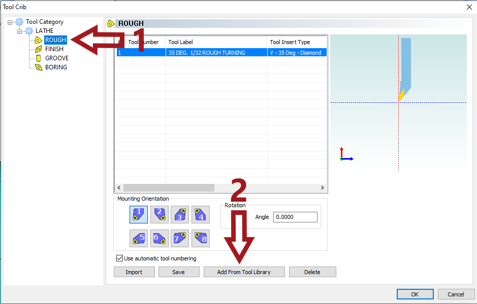

Pic. 4 – Tool Crib for Job
8. Once in the Tool Crib, select the tool type on the left hand side. In this example, we select the Rough type
9. Press the Add From Tool Library button

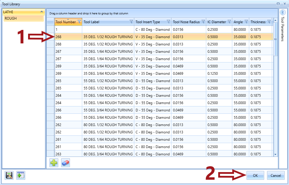

Pic. 5 – Tool Library
10. Locate the tool that you modified and select it
11. Press OK

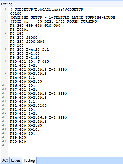

Pic. 7 – Example Posted G-Code
Pic. 7 Shows an example of the G-Code output after checking off the Reverse Sign box for the tool.
