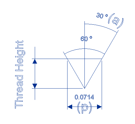

Lathe Single Point Thread - 2d depiction of Thread Height and Thread Depth
Input Geometry
The input geometry you select in the software is used to define the Maximum Triangle Height (See Thread Image)

Thread Height
The Thread Height in the software is simply applied as the full triangle height of a given thread and does not take into account any additional real world parameters.
Due to different thread types and applications requiring different formulas, the software simply uses a standard calculation to apply the entered thread height as the maximum triangle height (See formula below). It is the userโ€™s responsibility to enter a Thread Height value that will result in the appropriate Thread Depth to be created for that specific user application.

Thread Height Equation for a Standard Lathe Single Point Thread
Eq. 1 shows an example of a thread with the value for Pitch and Thread Angle.
Ex. 1 โ€“ Finding Thread Height
image of dimensions of one single point thread
Using Eq. 1 and Ex. 1 we get:
Example 1 Thread Height Equation and calculation
The thread height calculated number as you can see does not factor in all the varieties of thread fit. It is intended to give a generic calculation based on the thread angle and theoretical points. For all the varying thread types and fits, it is very common to have to adjust this thread height to dial it in to your exact requirements for your program.
