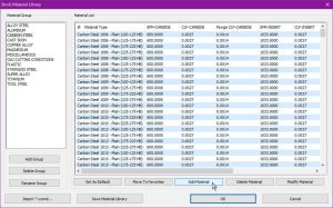

  1. Use one of the methods described above to open the Stock Material Library.
    Break Break The library opens on the default material group Carbon Steel.Any of the materials in this particular group can be set as default, deleted, or modified by highlighting it, and using the buttons below the list.For this example, however, we will add a new material. Break
  2. Click Add Material.

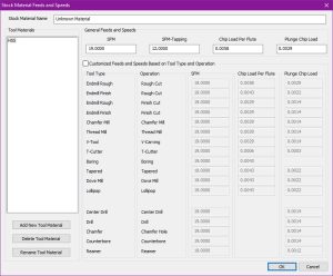

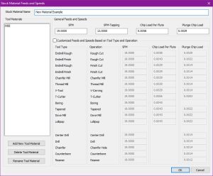

    Break Break The Stock Material Feeds and Speeds dialog appears. Break Break
  3. Update the name of the material.
    Break Break
  4. By default, the only Tool Material is HSS (High Speed Steel). Update the SFM, SFM-Tapping, Chip Load Per Flute, and Plunge Chip Load for the new material using a HSS tool.

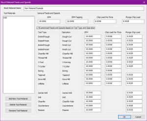

  5. If necessary, select the check box for Customized Feeds and Speeds Based on Tool Type and Operation.
Break Break This allows you to define specific speeds and feeds for each tool type and operation. Break

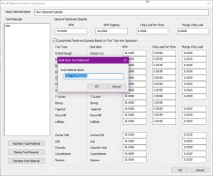

  1. Under the Tool Materials list on the left, click Add New Tool Material.
    Break Break The Add New Tool Material dialog appears. Break
  2. Name the new tool material and click OK.

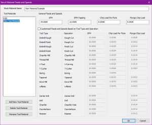

    Break The new tool material appears in the Tool Materials list. Break
  3. By default, our new tool material is selected to allow us to define its speeds and feeds in our current material.
    Break Repeat the process of setting speeds and feeds for this new tool material type when our New Material Example material is selected for a job. Break Break

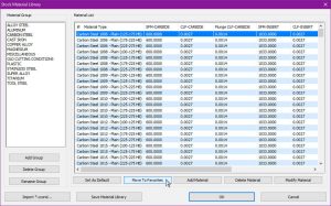

  1. Highlight one of the materials you use on a regular basis, and select Move to Favorites.
    Break Move To Favorites - Material Library Break The material is moved to a new group called Favorites. Break

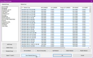

  1. Click Save Material Library.
    Break Save Material Library - Material Library in BobCAD Break The MaterialDB.xml is updated. Break
