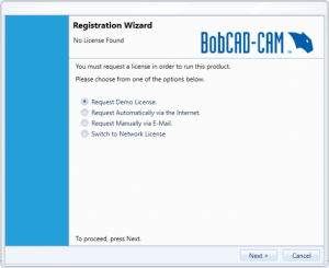

2. If the software is not registered,the Registration Wizard will appear. Select “Request Demo License.” and hit Next
Alternatively, you can open the Registration Wizard by going to File --> Help --> Activate License

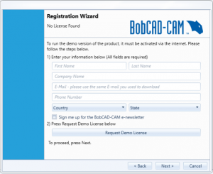

3. Enter your information and click the “Request Demo license” button when done and Click Next
Note: This will send you an email with a demo license file attached

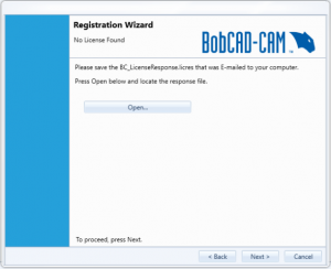

5. Navigate back to the Registration Wizard and click the “Open…” button
6. Open the license file and click Next
