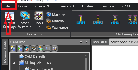

1. From the BobCAD home screen select file

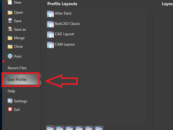

2. Next select User Profile

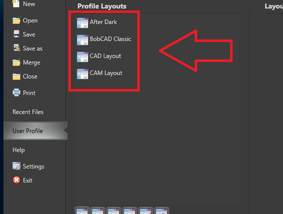

3. Then select one of the 4 available user profiles (The "After Dark" profile is the standard when first installed)
4. Right click on the user profile and select load
