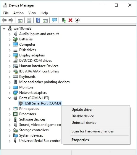

3. Open, “Device Manager” on your computer. Click the Windows button or search bar at the bottom left of your screen and search “Device Manager” to open
4. In Device Manager, you can access the “ports” and find your cable.
Note: Notice the COM number at the end of the name. You will need to remember this for later.
5. Right-click on the name and select, “Properties”
Graphical user interface, text Description automatically generated

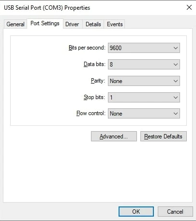

6. Select the “Port Settings” tab at the top to access the DNC settings.
Adjust the port settings on this page to match your machine specifications.
Graphical user interface Description automatically generated
Note: You can select the “Advanced” button to reassign the COM number if needed.

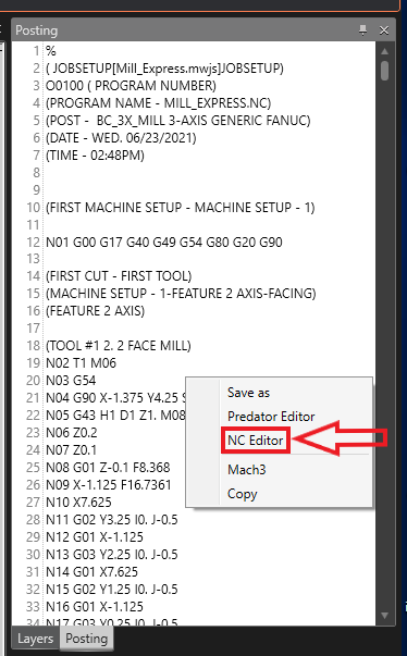

7. Create a sample program in BobCAD-CAM and open NC Editor (Right-click in the Posting Window)

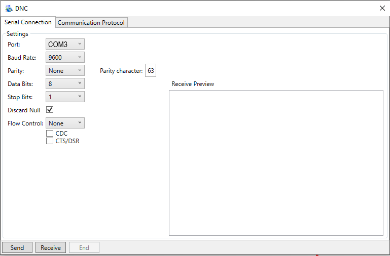

8. In NC Editor, go to the “Tools” tab and select, “Start DNC Transfer”
Graphical user interface, application, table, Word Description automatically generated
9. Setup the port settings to match the Device Manager settings and select your Port from the drop-down list.

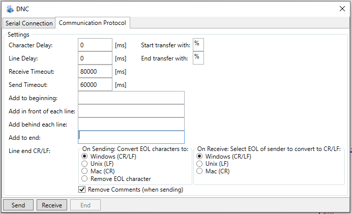

10. Additionally, you can setup Delays, Timeouts and Comments on the “Communication Protocol” page to fine-tune your settings.
11. Hit “Send” or “Receive” when done
