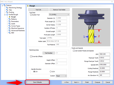

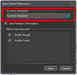

the "Save Defaults" button will be visible at the bottom of the Feature page, and all subsequent pages in the Feature Wizard (See picture below). You can set the values you want as default, in the Mill Wizard first. Then, hit this button to save out a template. This will save and store data into a template from the current Feature like, the Feed Plane and the Rapid Plane values as well as Top of Feature and Total Depth.

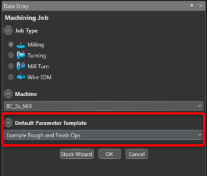

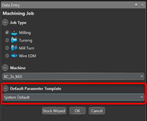

When starting a New Job, you can then pick the Default Template you saved in the "Default Parameter Template" section and it will load your new default parameters.

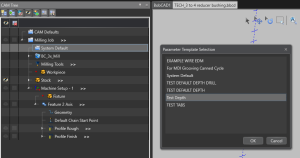

You can also adjust the current Default Template in an existing job by going to the CAM Tree, right-clicking on the current Template in the job, and selecting "Edit"
With the proper template saved to the CAM Tree, every feature and operation which has had custom parameters saved to the template will automatically be loaded with those parameters as their default values. Follow the step-by-step below to found out how to set up a Template with the "Save Defaults" button

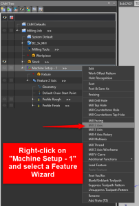

1. Open an existing feature wizard or start a feature in the CAM Tree.
(eg. right-click on "Machine Setup - 1" and select "Mill 2 Axis")
2. Go through the wizard like normal and setup all the default parameters you would like to use. When done click “Save Defaults.”

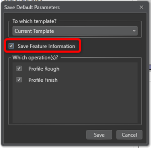

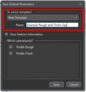

3. Once in the “Save Defaults” menu, you will need to choose which template to store the information in.
Note: It is recommended to start by saving in a new template to retain all BobCAD default parameters in the "System Defaults" template
Note: Select the "Save feature information" box if you want the Feature Data stored In the Template
  • Current Template - saves the current parameters to the currently selected template. This option is only available when saving to Default Parameter Templates.

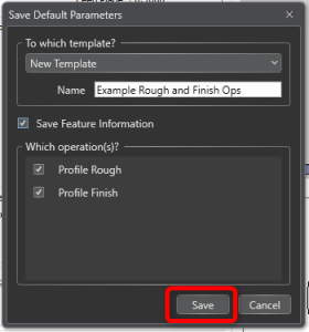

  •  New Template - allows you to create, and name, a new template to save the current parameters to.

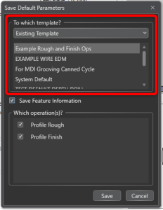

  • Existing Template - allows you to select from a list of existing templates to determine which template will have the current parameters saved to it.
    • This list will display all currently existing templates. Click on one to highlight it, and this will be the template which has the current parameters saved to it.
4. Last, you will choose the operation that you want to save the defaults for, by default all the operations are selected, if you want to exclude the data from an operation in the Template, click the box next to the operation.
5. Click "Save"
6. Finally, to use these new Default Parameters, just make that you select the Template you saved when starting new job under the "Default Parameter Template" section
