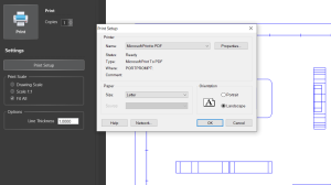

2. Navigate to File > Print and select "Print Setup"
3. Select "Microsoft Print to PDF" in the drop-down box and click "OK"
Note: You can adjust the Page Orientation here as well if needed.
4. Click the "Print" button and Save the PDF to your computer.

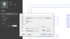

3. Navigate to File > Print and select "Print Setup"
4. Select "CutePDF Writer" in the drop-down box and click "OK"
5. Click the "Print" button and Save the PDF to your computer.

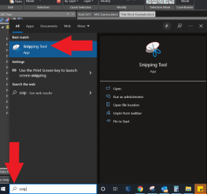

Snipping Tool is a Microsoft Windows screenshot utility included in Windows Vista and later. It can take still screenshots of an open window, rectangular areas, a free-form area, or the entire screen.
1. "Search" for "Snipping Tool" using the Search bar at the bottom left of the taskbar of your computer. Select the "Snipping Tool" when is pops up.

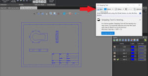

2. Click the "New" button to start the screenshot.
Below is the rectangular box that was selected for the screenshot.

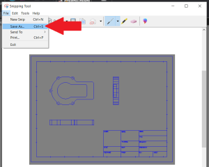

3. Go to File > Save As... to save the picture file to your computer.
