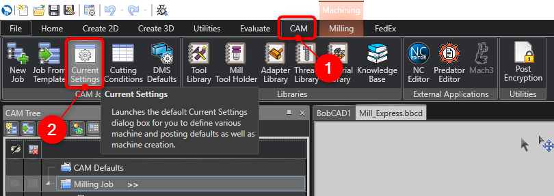

1. To navigate to these coolant options, go to “CAM” > “Current Settings” at the top ribbon of the software
Go to Current Settings in BobCAD-CAM
Pic. 1 – Go to Current Settings

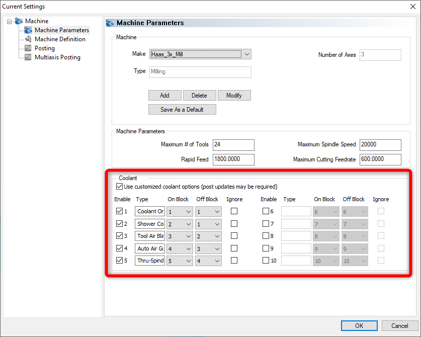

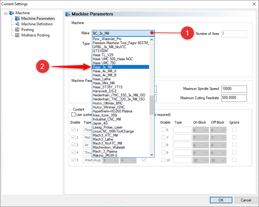

2. On the initial “Machine Parameters” tab, select the “Make” drop-down box and select your machine.
Select Your Machine in BobCAD-CAM
Pic. 2 – Select Your Machine
As you can see in the picture below (pic. 3), the default Haas 3x Mill machine already has some default Coolant Options pre-configured, such as the Thru-Spindle Coolant.
Coolant Options in BobCAD-CAM
Pic. 3 – Coolant Options
Type – Allows you to give the Coolant option a name. This will show up in the Feature Wizard when selecting the coolant type you want to use for that operation.

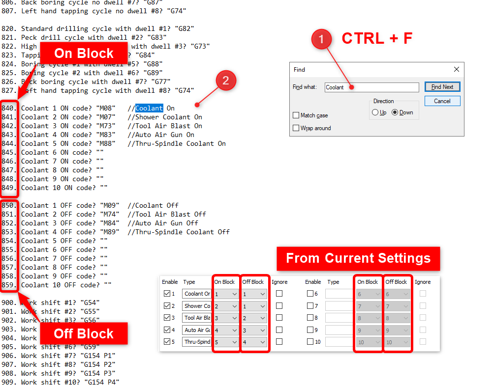

On Block Column – Corresponds to the Coolant On M-Codes that are set up in the post processor on Blocks 840. – 849. (Keep reading to see how you can modify these.)
Off Block Column - Corresponds to the Coolant On M-Codes that are set up in the post processor on Blocks 850. – 859.

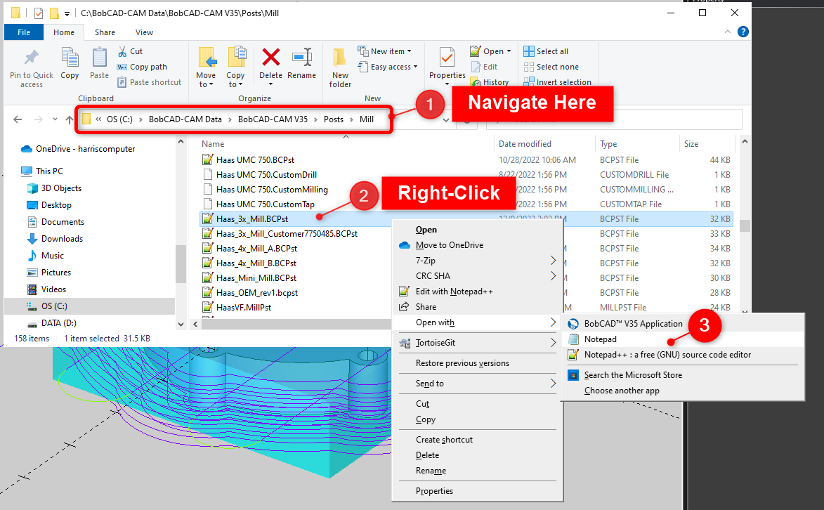

3. Open a “File Explorer” on your computer. Then, navigate to the BobCAD-CAM Data folder file path (C:\BobCAD-CAM Data\BobCAD-CAM V35\Posts\Mill), right-click on your machine, and select “Open with” either “Notepad” or “Notepad++” if you have it.
Open Post Processor (C:\BobCAD-CAM Data\BobCAD-CAM V35\Posts\Mill)
Pic. 4 – Open Post Processor (C:\BobCAD-CAM Data\BobCAD-CAM V35\Posts\Mill)
4. Next, press “CTRL+F” or go to “Edit” > “Find” at the top toolbar to search for the word “Coolant”. Hit the “Find Next” button until you get down to blocks 840-859
Picture depicts the Haas Post Processor .bcpst file opened and showing Blocks 840-859 to setup Coolant M-Codes
Pic. 5 – Blocks 840-859 to setup Coolant M-Codes
Observe in the pic. 5 that 840. – 849. are reserved for the Coolant On M-Codes (“On Block” column on the Current Settings page) and 850. – 859. Are reserved for Coolant Off M-Codes (“Off Block” column).
Note: If you have an older post processor, you may not find these blocks in the post processor. You can insert the following text below in-between blocks 827. And 900 just like you see in the image above (pic. 5) to get you started.
Copy and Paste the text below and insert it into your post processor between blocks 827. And 900: 840. Coolant 1 ON code? "M08" //Coolant On

Note: There may be other Blocks already between 827. And 900. If this is the case, just fit the Coolant Blocks in numerical order. Note, this is simply all visual preference as the post processor does not care where exactly these blocks are placed. They simply just need to be in the post processor.

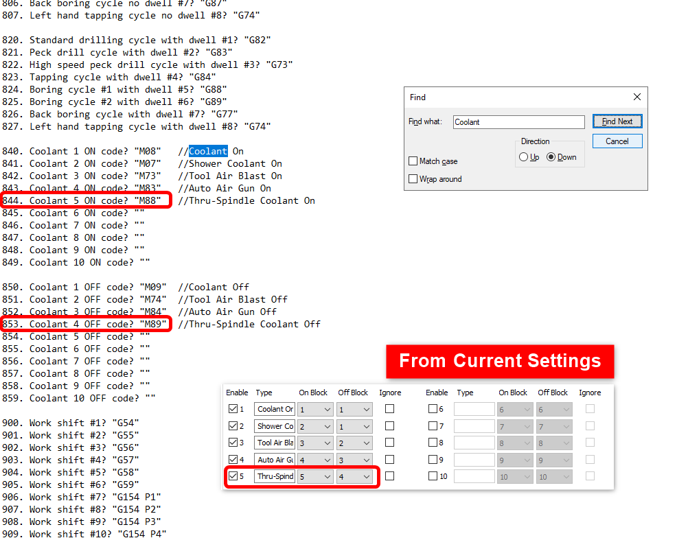

Setting Up Thru-Spindle Coolant in 3x Mill Haas Post Processor
Pic. 6 – Setting Up Thru-Spindle Coolant in Post Processor
You can observe in pic. 6 above that the Thru-Spindle Coolant On M-Code is designated for Coolant On number 5. However, the Coolant Off M-Code is designated for Coolant Off number 4. This is why when you set up the Thru-Spindle Coolant in the Current Settings, the On Block is set to 5 and the Off Block is set to 4.
You can modify or add more M-Codes here in this portion of the post processor to fit the specifications for your specific machine. As you can see on the “Current Settings” page and from the example Thru-Spindle Coolant, that you can choose which number corresponds to which M-Code. This allows you, for example, to utilize the same Coolant Off M-Codes for multiple Coolant Types.

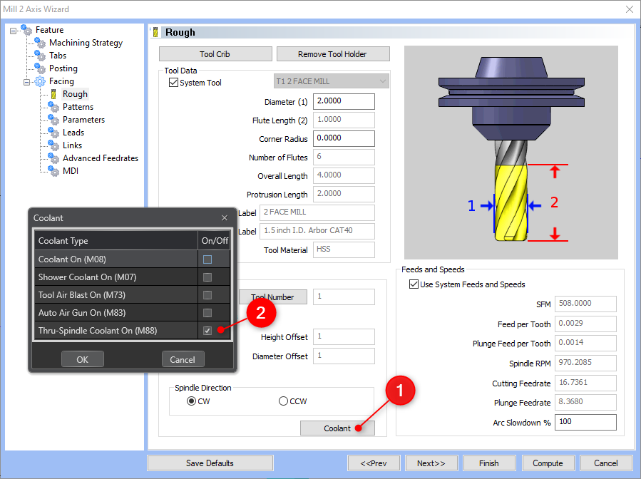

5. Once you have enabled and set up your custom coolant commands, you can go to the Tool Page in a Feature Wizard and select “Coolant”. Then, enable all the coolant types needed for that specific operation.
Select Thru-Spindle Coolant in the Feature
Pic. 7 – Select Thru-Spindle Coolant in the Feature

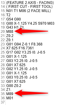

6. Finally, post out the job and observe in the NC file. You should now see your Coolant On and Off M-Codes at the beginning and end of that Operation.
Thru-Spindle Coolant in the posted G-Code
Pic. 8 – Thru-Spindle Coolant in the posted G-Code
