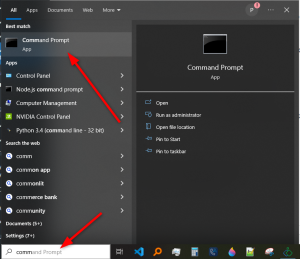

2. On your computer search for "Command Prompt" in the bottom search bar

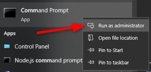

3. Right-click on "Command Prompt" and select "Run as Administrator"
