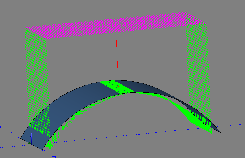

This document will describe how to fix surface normals for a multi-axis feature. You may need to do this if you see that the toolpath was created inside of the model. The reason this is happening is because of how the surface normal is orientated on that surface.
The example below shows a multi-axis feature using Parallel Cuts for the surface toolpath.
Pic. 1 โ€“ The Multi-Axis Toolpath Issue

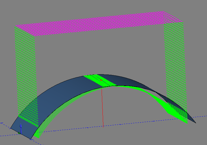

1. Go to Utilities Reverse Surface Normal
This will show which way the surface normal is facing and will allow you to reverse the direction of it.
Pic. 2 โ€“ Surface Normal Shown on Surface
Note: The surface normal should always be pointing outwards from the model.

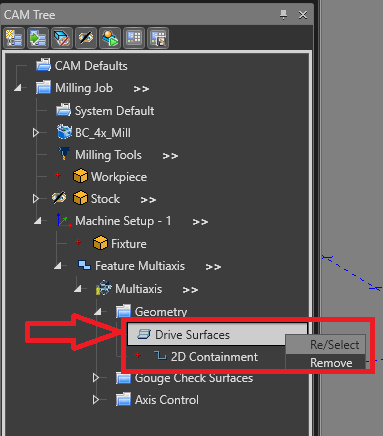

3. Go back to your CAM Tree and Re-Select your drive surface for the Multi-axis feature

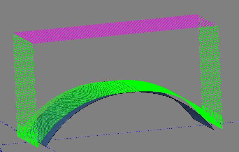

4. Right click on the feature and select โ€œCompute All Toolpathโ€
Pic. 4 โ€“ Re-Computed Toolpath
