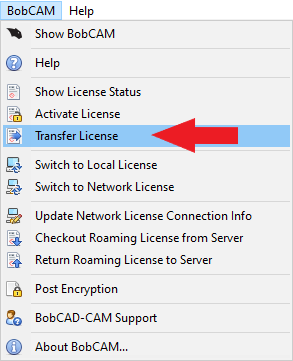

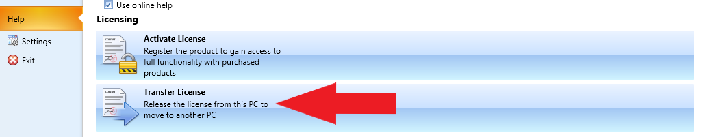

1. After opening up the BobCAD software program, click on File in the top left corner and then click on Help.

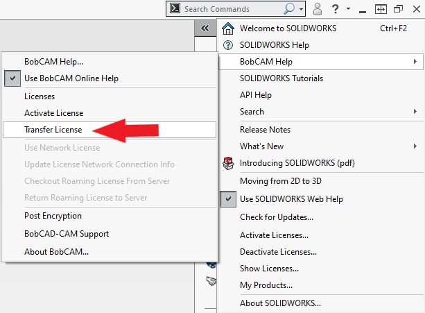

For BobCAM for SolidWorks: click to drop-down question mark arrowย  and go to BobCAM Help
For BobCAM for Rhino: Click the BobCAMย  ย  icon
2. Select the option Transfer License.

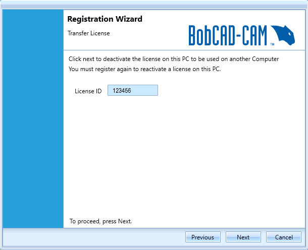

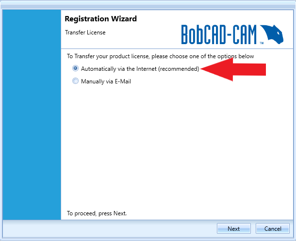

Transfer Automatically via Internet (recommended)ย
3.1 Select transfer Automatically via the Internet, then click Next.
NOTE: The license will be removed from that computer, and the user can now register with the same license ID and password on a new computer.
4.1 click Next.
Note: Make sure to note down which License ID you are transferring. You will use that same license ID and password to re-register on the new computer.

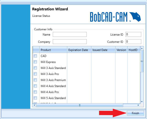

5.1 Online Transfer Success! click OK.
6.1 To finish the transfer, click Finish

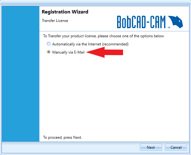

Manually via E-Mail
3.2 Select Manually via E-Mail, then click Next.

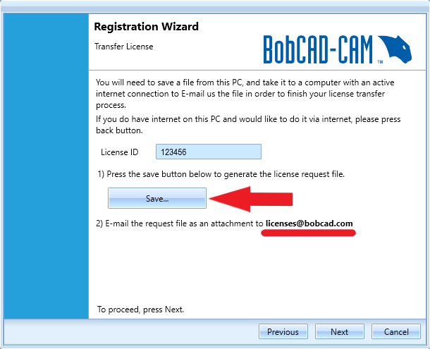

4.2 Click the "Save..." button to save the license file and send an email to licenses@bobcad.com with the license file attached
Note: You will get an automated response back. This can take some time to come back depending on the amount a traffic. Please give it some time to send a response back.
