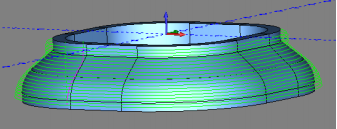

Pic. 1 - Toolpath When Using the “Extents” Cutting Extents
A picture containing sky Description automatically generated Chart Description automatically generated
The extents will stay within the bounds of the surface in the X,Y directions. The outer boundary of the part is automatically calculated. The calculated toolpath is then contained inside the outer boundary using the tool tip as the calculation point.
You will want to use either 3D extents or part bottom if you want to machine further down the geometry.

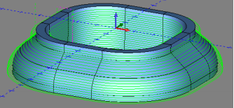

Pic. 3 - Toolpath When Using the “3D Extents” Cutting Extents
A picture containing indoor Description automatically generated Chart Description automatically generated
The 3D Extents will extend the boundary to create toolpath further down the surface. This will help get the edges of the model. The outer boundary of the model includes the bottom edge of the selected surfaces at the outermost extremities.
This one is a great option if you just want the toolpath to create toolpath down the surface to include the edges of the surface as well.

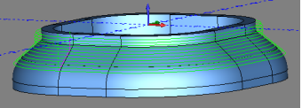

Pic. 5 - Toolpath When Using the “Part Bottom” Cutting Extents
Chart, diagram Description automatically generated
Part bottom will create toolpath all the way down to the bottom of the part. The outer boundary of the model is calculated from the lowest Z-axis value. The toolpath is calculated to include this area.
However, if you wanted the toolpath to go down past the corners of the model, but do not want to go all the way down the part. You can use “Bottom of Job” located on the Parameters page in the feature. You can customize this value to adjust how far you want to toolpath to go down the part.
