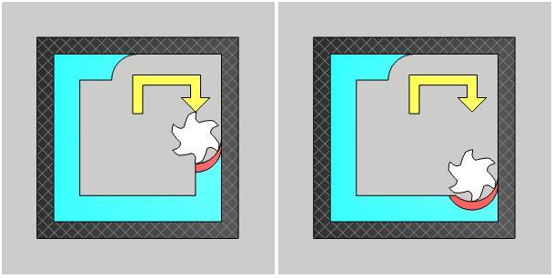

The Corner Slowdown option is available in many operations now including pocket, profile, engraving, chamfer, and corner rounding. You can cut your feed rate to a specified percentage when you approach corners. Many variables need to be taken into consideration, especially ensuring the tool does not engage too much material at the same time. Having the tool engaged in the material too much can easily break a tool. When moving around a part, additional stock is always encountered in the corners.
Corner Slowdown - CAM feature found in BobCAD-CAM V33
In the image above, notice how much additional material the tool is engaging in the corner (About 25% of tool engagement on the sides, but about 50% tool engagement in the corners). While you may want to remove material as quickly as possible, scenarios like this have to be accounted for, and until now, that meant having to slow the speed on the rest of the path as well. Now, with the new Corner Slowdown feature, simply specify how close the tool should get to the corner prior to slowing, and the percentage to slow the feed rate down to and you’re done! The toolpath is broken and the feed rate is reduced by the specified percentage.
This feature will even allow you to divide the specified distance into a number of segments so the feed rate gradually drops to the specified feed rate percentage. Now, you can finally set your speeds as fast as you can and focus on slowing down the toolpath in the corners when absolutely necessary.
