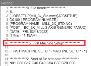

You can open a post processor using Notepad. Post Processors are located here: C:\BobCAD-CAM Data\BobCAD-CAM V(Version #)\Posts\(Machine Type). You will find that these post variables are contained inside separate Post Blocks. For example, the picture below shows a tool change block which is denoted with the number 3 (Line 3) and the post variables being utilized to output g-code for a tool change.
Note: Characters contained inside of quotation marks, ex. "(EXAMPLE CHARACTERS)", will be hard coded into the NC file. This means that they are just static values that do not utilize the program made in the software and will simply be output every time in the NC file.

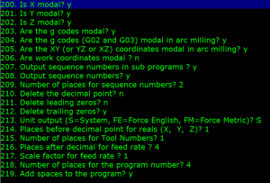

The post processor also consists of posting questions that make easy to adjust certain aspects of the NC file output. For instance, if you do not want sequence numbers at the beginning of each line of the NC program file, you can adjust Block 207 and Line 208 (shown below) to n. When you save and repost the program in BobCAD, it will remove the sequence numbers.

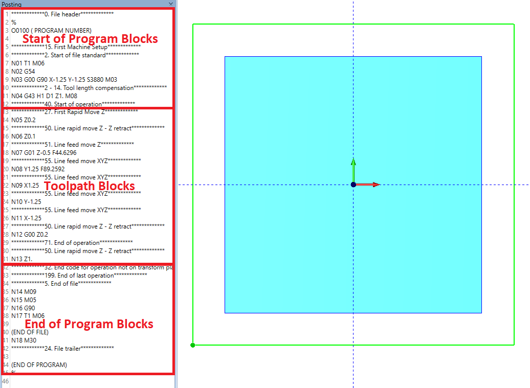

There is even a line (typically Line 26) to turn on debugging. With this on, you are able to view what blocks are being utilized and posted out in the NC file. This will allow you to find the specific block that is being output from the post processor and make adjustments to that specific block.
Output of the NC file below:
Example of a Posted Program:
Note: This NC program file is in debug mode. The debug lines that denote the post blocks only show up when debug mode is turned on
In the example program below, the toolpath is performing a cut along a square where the tool will plunge into the bottom left corner and will then feed around the profile of the square. When posting out the NC program file, blocks 0, 15, 2, 14, 40, and 5 are called out to setup the beginning and ending of the program. Between those blocks, there are also blocks 27, 50, 51, and 55 being called out in this example. These blocks are utilized to control the feed type, feedrate and X, Y, Z movements of the tool. (If you have multiple operations in the BobCAD program that utilize multiple tools, you will also notice tool change blocks being called out in the NC file as well.)
