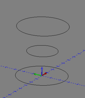

1.  Create a wireframe of the model using the Create 2D tab
Shape, circle Description automatically generated

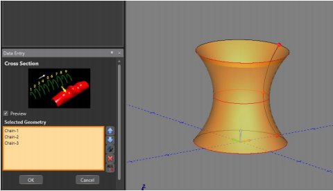

2.  Go to the Create 3D tab and select Cross Section in the Surfaces section.
3.  Create a chain with each circle. Hold SHIFT + Left Click in the same location on each circle. (Make sure all chains are facing the same direction.)
4.  Click OK then Cancel
Chart, funnel chart Description automatically generated

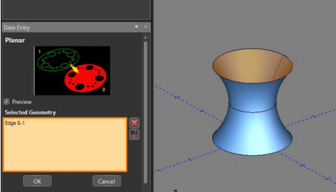

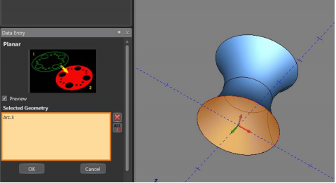

5.  Click Planar in the Create 3D tab in the Surfaces section
6.  Select the top edge of the model as your geometry.
7.  Click OK then Cancel
A picture containing text, monitor, screenshot Description automatically generated
8.  Repeat steps 5-7 for the bottom edge of the model.

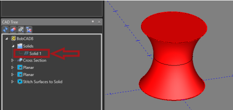

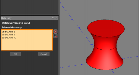

9.  In the Create 3D tab, select Stitch Surfaces to Solid in the Modify section
10.  Select all three surfaces created and click OK then Cancel
A picture containing text, indoor, screenshot Description automatically generated   A picture containing diagram Description automatically generated

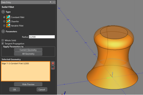

11.  In the Create 3D tab, select Solid Fillet
12.  Type in the desired radius and click on the outer top edge of the model
13.  Click OK then Cancel

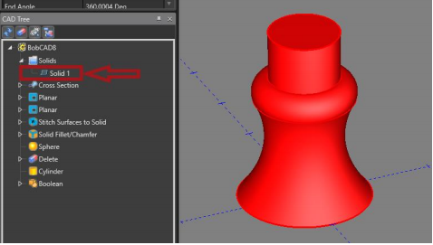

14.  In the Create 3D tab, click Cylinder and create a cylinder that intersects the model
15.  Click OK then Cancel to complete the cylinder

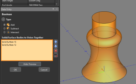

16.  In the Create 3D tab, select Boolean Add
17.  Select both solids and click OK then Cancel
