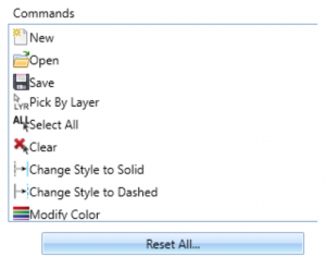

3. Under the β€œCommands” list left click on the specific feature that you want to create a shortcut for.
Pic. 2 Commands

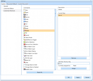

4. To create a new shortcut key left click on the β€œAdd New Shortcut Key” box
Pic. 3 Adding a New Shortcut Key
5. Now type on your keyboard the keys you want to use in BobCAD to pull up the specific command.
Note: All shortcuts must include the control key; ex. Control + B.
6. Hit Assign to add the shortcut
7. Follow steps 3 through 6 for any other commands that shortcuts are wanted for.
8. To finalize all changes hit the apply button
9. Click ok
Pic. 4 Customize Shortcut Window
