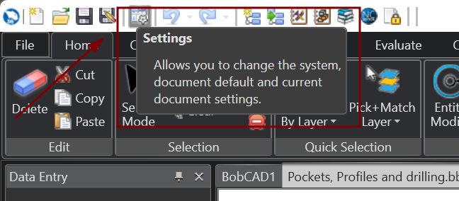

1. Click the settings menu icon, just above the ribbon.

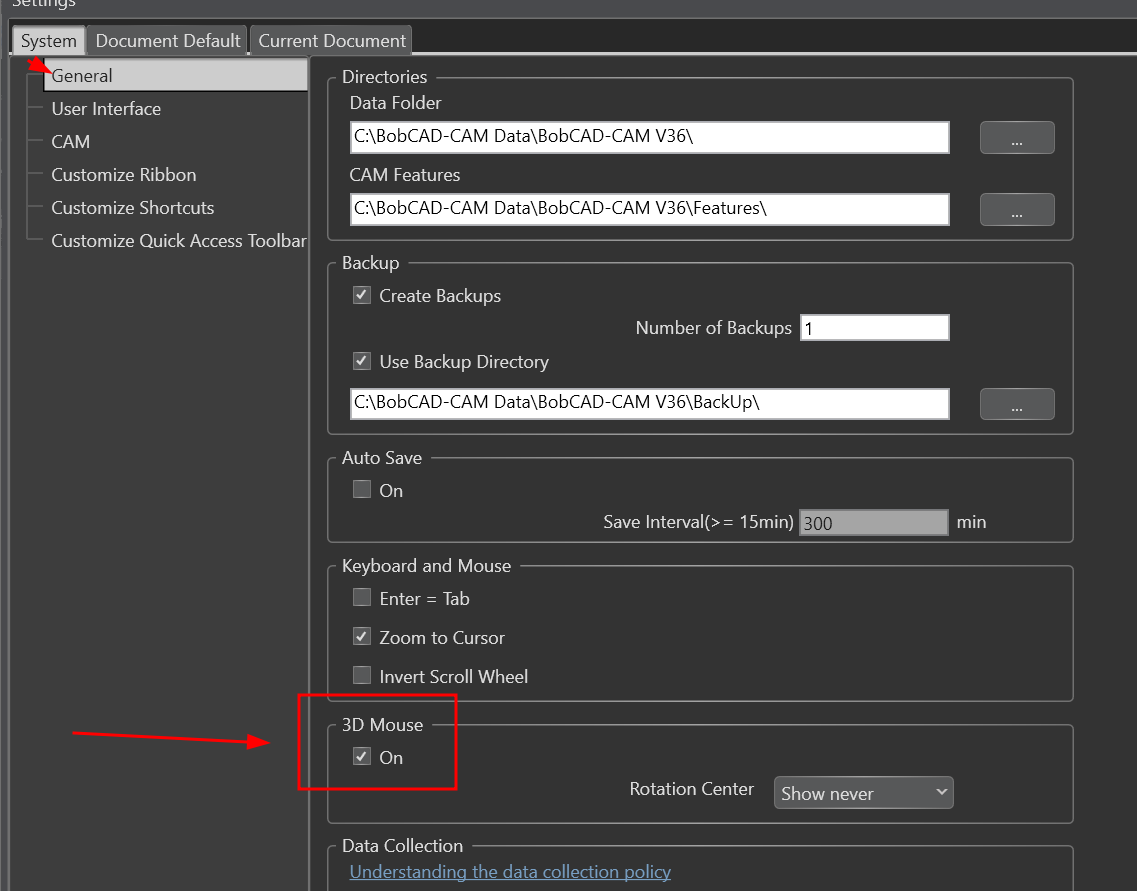

2. Make sure the “General” tab is selected from the left-hand column. Make sure the box is checked to “on” underneath “3D Mouse”.

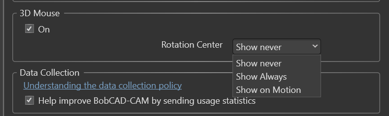

3. The “Rotation Center” setting is a personal preference. You can have the center of rotation for the 3D mouse appear in the display area all the time, only when you are using the 3D mouse, or not at all.
